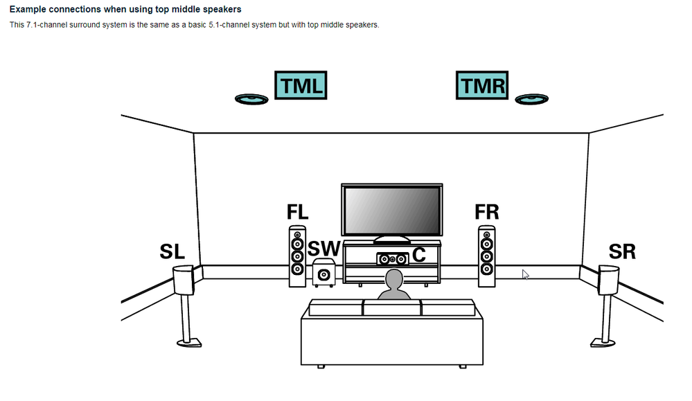

  Can i ask those with a 5.1.2 (see below) ATMOS setup if when watching BT Sport premier league football on Ultimate how they find the volume of the center channel and commentary?
I have a Denon AVR-3500H and it sounds perfectly good for DVD / Blu-ray but for sport i seem to be drowned in crowd noise from the heights (TML /TMR) and a very low center channel volume for the commentary.
I have checked the DB levels from the speakers using a sound meter / test tones to confirm my setup is ok, but even if i pump up the center 3 or 4db it still sounds low.

Not really an answer but I know I have to have the Audyssey/Dynamic Volume set to light to ensure I get clear dialogue from the center channel.
