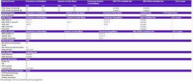

I doubt you have G.Fast, it is not widely available and unless you had ordered it, I doubt you will have it.
If you put your phone number in the checker https://www.broadbandchecker.btwholesale.com/#/ADSL you will see if G.Fast is available.
Post a screenshot after deleting your phone number if you are not sure.

No, you don't have G.Fast, its not available at your location.
