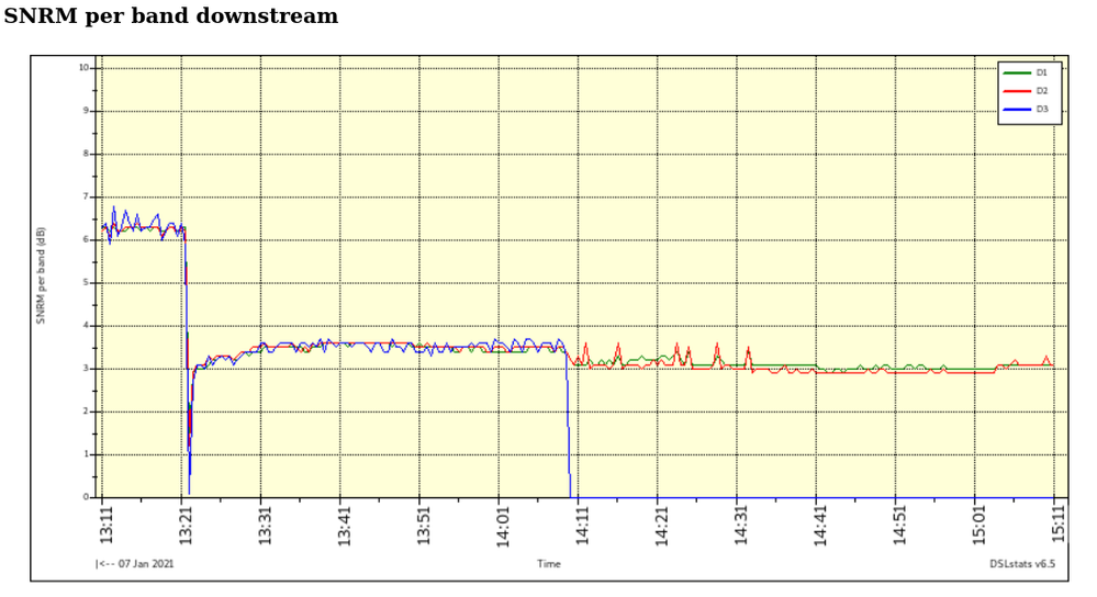

I'm in an unusual situation where my sync speed is more than my attainable. However recently I've noticed that one of my downstream band SNR has dropped to 0 does anyone know what would cause this?
I've done a noise test on the line - no issues
DSL stats below

Stats recorded 07 Jan 2021 15:38:04
DSLAM type / SW version:	BDCM:0xa4a1 (164.161) / v0xa4a1
Modem/router firmware:  	AnnexA version - A2pv6C038m.d24j
DSL mode:               	VDSL2 Profile 17a
Status:                 	Showtime
Uptime:                 	1 day 3 hours 0 min 48 sec
Resyncs:                	5 (since 25 Nov 2020 17:20:02)
				Downstream	Upstream
Line attenuation (dB):  	22.1		0.0
Signal attenuation (dB):	Not monitored
Connection speed (kbps):	39545		9047
SNR margin (dB):        	3.1		5.9
Power (dBm):            	13.3		6.3
Interleave depth:       	4		1
INP:                    	52.00		0
G.INP:                  	Enabled		Not enabled
Vectoring status:       	5 (VECT_UNCONFIGURED)
RSCorr/RS (%):          	1.0730		1.6974
RSUnCorr/RS (%):        	0.0000		0.0000
ES/hour:                	3.07		1.79
