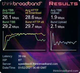

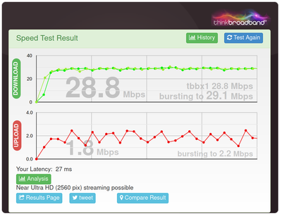

Hi @pippincp , thanks for the link.
Here is the result (hardwired to the router and the only device connected). I confirm that this evening I get similar results from speedtest.net and other checkers, though to be fair they report a high speed at the very start of the test before dropping to a stable 2 Mbit.
https://www.thinkbroadband.com/speedtest/1611860779828270755
Modem is connected at 6758 up / 32399 down, DSL uptime 10 days 12 hours with no retrains. Previously tested with an NL8800 and HH5b, similar results. This one is an HG612.
Results the same from Firefox and Chrome.
I also ran the special test for cabinets with congestion. Here are the results:

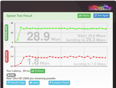

To round this off with some more data, here is the same speed test result when connected direct to the modem:
PC <-- cable / PPPoE --> modem <-- cable VDSL2 --> cabinet
There is clearly something not right:
Without trying to make assumptions about what might be going wrong in the BT / Openreach systems, the real question is what can I do about it? Is there any advice?

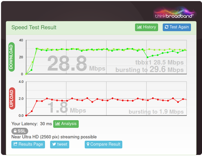

Good morning folks, still trying to diagnose this 2Mbit/sec upload issue and managed to capture the burst / stable upload speeds on the checker recommended by @pippincp . This profile is consistent with nearly every other checker (apart from BTW official which only records the peak value).
Modem is currently syncing in at 6681 on the upstream side which is my focus for now, so I would expect throughput at around 5Mbit / sec which is what it sees at the peak before it is limited. (on the upload plot you can clearly see this - a very high peak at the start and then a stable level for the rest of the test)
Knowing that
  • This line used to be at a 2Mbit / sec profile
  • Openreach are able to cap lines at 2Mbit / sec without it being seen on sync speed
  • This line is being capped to 2Mbit / sec upload
Is there any likelihood that
  • The IP profile is correctly set but that there is an equipment fault in the cabinet which is causing the limit
  • There is another limit in the Openreach system which does not appear under the IP profile associated with the line (I'm not sure how the caps in SIN498 are applied, but up until now had assumed they would be reported in the IP profile)
  • A previous BT limiting system has a memory of an old profile for this line, but this has not been disabled (I'm not sure what that would be, but I'm sure this line has not been unlimited for ever)
 I may be barking up the wrong tree but I'm almost certain we have a stuck profile of some kind somewhere.
1612162095444975655
(Don't worry about the download results here - this particular laptop happens to be on 2.4Ghz wifi so the result is not valid - no such problem for these upload speeds though, and the result is consistent across a range of devices and wired / wireless connections)
