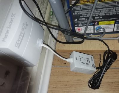

I have a Mastersocket 5C on the wall (One connection port)
Plugged into the Mastersocket is a ADSL filter. There is a broadband RJ11 plugged in the modem port to the RJ11 connection point on the Smarthub (Broadband port).

I intend to buy an ASUS RT-AX88U. My setup is Master socket 5C with an ADSL filter plugged in. Then RJ11 broadband cable to my BT Smarthub RJ11 port. I have Fibre to the cabinet.
