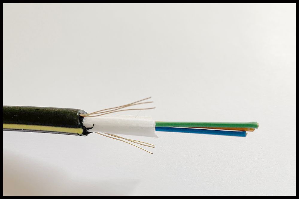

Fibre when stripped looks a little like this pictured below. (Yes I did it)😋
Inside those green, blue & orange are tiny strands of fibre as quoted no larger in diameter than a strand of hair.
Only one strand will supply you're premises which of course is quite amazing IMO.

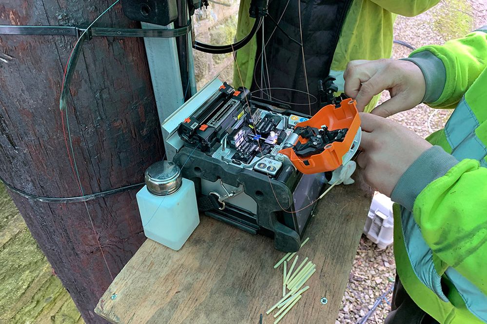

They are spliced together with an expensive splicer costing anywhere in the region up to £10k in some cases.
Here are the contractors working on my build showing the single strands being spliced together.😉
