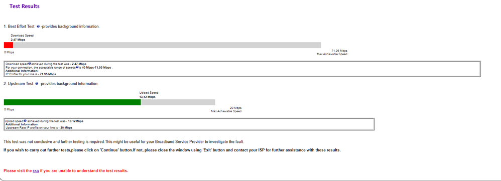

I contacted BT on the 06/07 to report a problem with my infinity 2 download speeds. Spoke with a really nice guy who was into gaming as much as I am 😄
I told him that my download speed has drastically droped from my usal 65Mbps to only 3Mbps. The upload is fine. My download speed has been a constant 65Mbps for many years
and this is the first time I have had issuse since upgrading to fibre.
I explained that this occurs on my ethernet connected pc and on all other devices in the property.
The router is connected to the master socket.
I have reset the router to factory settings, changed all the cables and have tried another router but still get the same results.
We ran a speed test using the BT Wholesale tester and uploaded the results to the server, and agreed there is a fault needing to be fixed.
I have ran some tests on the BT Wholesale site at diferent times.
At 6:30 am the speed seem to be fine at around 65Mbps
But by 8:00 am it has already dropped to 15Mbps.
At 18:00 it has dropped futher to 4Mbps
By 10pm it is down as low as 2.80Mbps
This seems to be the pattern everyday.
Unfortunatly the problem still persists and I contacted BT again, They have scheduled an engineer apointment fo the 11th but I'm sure it's a capasity isssue at the exchange at LLANBEDROD cabinet 5.
I would be very grateful if you could look into the matter for me.
Thank you.

Sorry for the problems you're having with your broadband speed during peak times.  I have checked your exchange for any known issues but nothing obvious stands out.
We will need your details to see exactly where your connection goes and we'll be able to see for certain then if there are any congestion issues.  Click on my username here >> RobbieMac << and you'll see our contact link underneath my profile picture.

I dont live anywhere near you but I have a very similar problem to you On infinity 1 No problems until Friday afternoon when everything slowed down. Did a BT speed check Friday night and diagnostics  and around 2mb/s .All weekend it was below 7and often under 2mb/s  Did another diagnosic exercise Sunday evening still very low speed
Monday morning.from 8 until noon it was up to 28 and then dropped right down to under 2 during the day . Had live chat with BT who eventually  said problem was outside my house .
This morning speed was nearly 40 but dropped during day to under 2again .Have had text messages from BT that problem is in house and to do various tests and test through test socket etc and then this evening a call from BT where we went through changing channel frequences etc . Then get text telling me service is back to normal ,currently getting under 2mb/s Upload speed is fine and always about the same . But service is definitely not back to normal.
