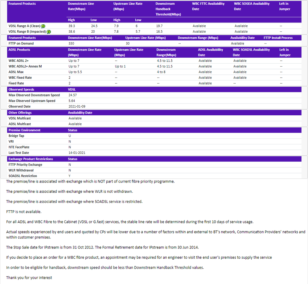

Have you checked what is available?
Enter your phone number into this form and display the results here, but edit out your phone number before you post the results.

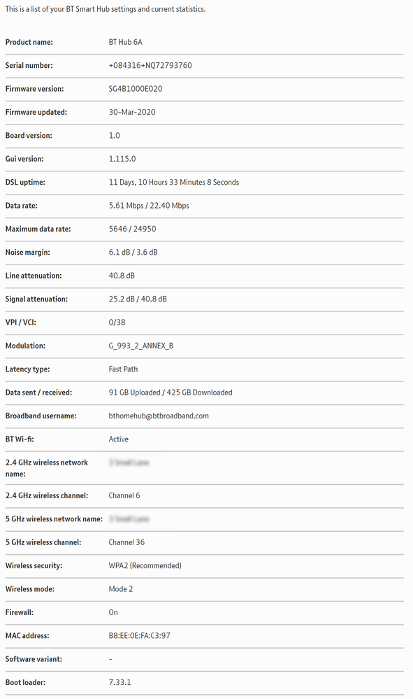

 please can you post the stats from your router (if hub enter 192.168.1.254 in your browser) and if  HH5 then go to troubleshooting then helpdesk and if HH6/SH2 then advanced settings then technical log information .
Someone may then be able to offer help/assistance/suggestions to your problem

You were showing a connection speed of 24.7Mbs on 14th January, which is only just above the lower limit for Range A.
Its possible that your internal wiring may be affecting the speed, or even a noisy phone line.

Thanks @imjolly - router information screen attached below as suggested.

checker shows speed range 39/24mb and you could get anywhere inbetween
hub stats will help

Something is not right there. I would suspect an internal wiring issue, or a very poor quality line.
You need to prove your wiring first.

from looking at your stats your noise margin is already down at 3db showing G.INP active and boosted you speed so doubt there is anymore
are you using the master socket?  have you tried using test socket with filter
