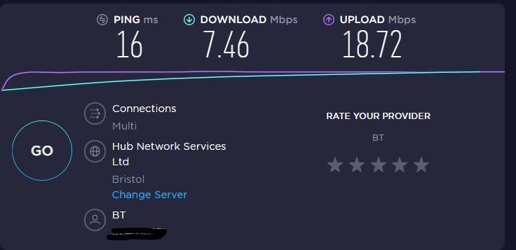

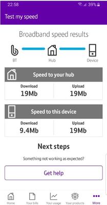

My BB speed has dropped down to as low as 2mb  (currently hovering between 5-20)on a 70mb  (min 55mb Guaranteed) to the point its practically unusable and definitely not what i  signed up for. i would be happy eve if it was 50Mb but 2mb my 4g phone is faster
I've been forced to open a fault about slow broadband speed but due to the awful speed and issues with your speed test i'm unable to complete the simple diagnostic speed test that you require via the website so you have removed my right to terminate my contract. It's not my fault your speed test isn't/wont work...

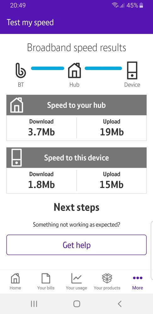

I did however manage to run a speed test on the mybt app and results are as below along with results for various other speed results sites.
removed mac and BB username
19Mb connection to the hub? when it should be 70-80Mb

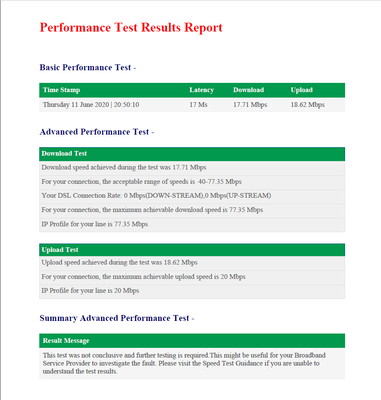

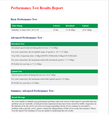

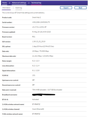

from your stats you have the max speed 80/20mb for fibre 2

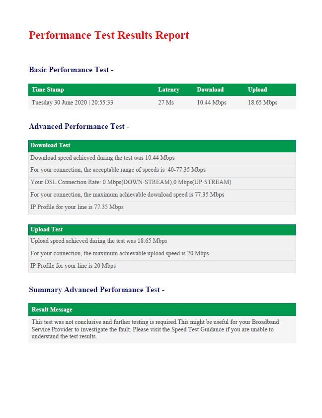

can you run btspeedtester and post results please  one when speed seems ok and then another when speed is bad
must be done with ethernet connection
which exchange and cab are you on?
https://www.speedtest.btwholesale.com/
4,096 Views
Message 4 of 11
Re: horrendous Fiber speed
One from Thursday evening and one from this morning, Im also connected to the Cwmbran Exchange and being served by Cabinet 40, all my connections are Ethernet except for phone/tablet

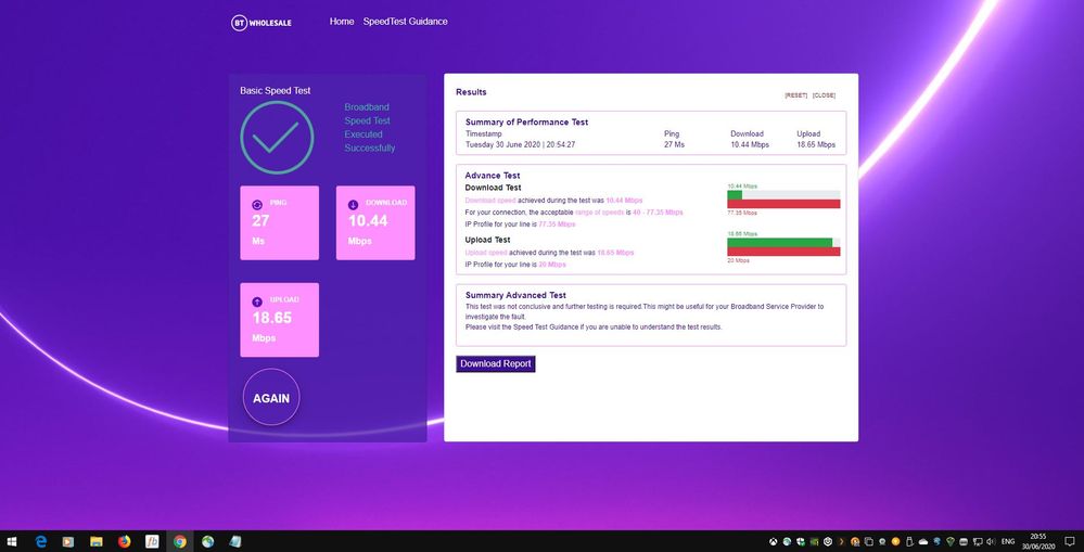

Still seeing horrible speed to the point its nearly unusable, see the BT guy at Dslam most days 😕
Previous ticket was closed with no resolution, or response, have had to open a new ticket
