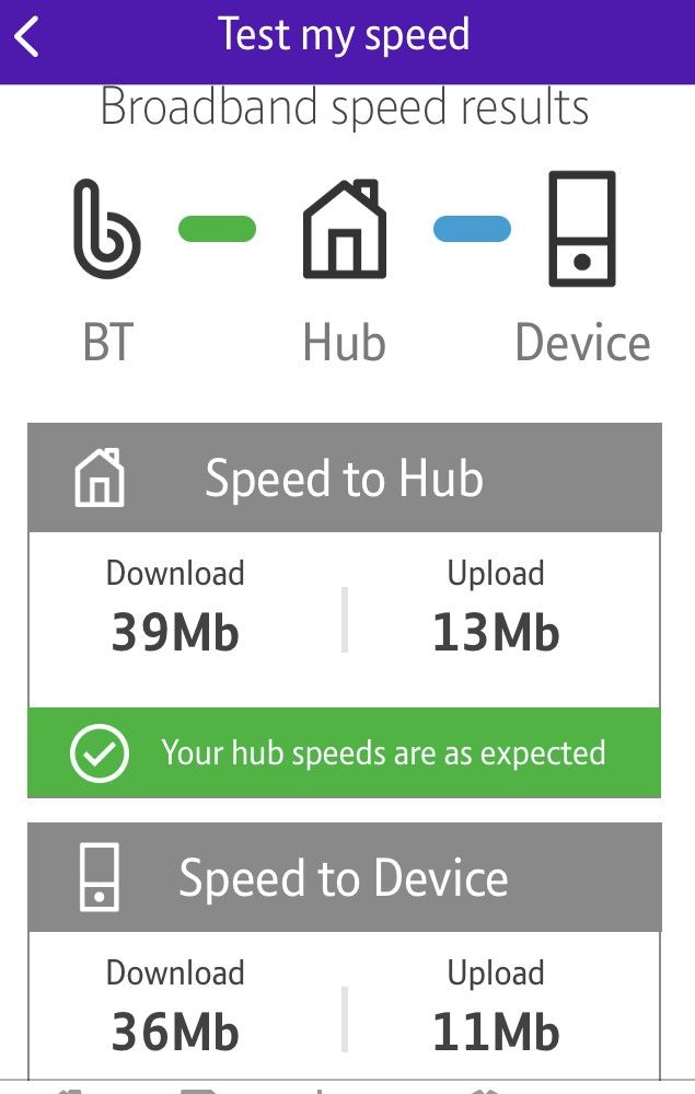

But now only getting around the 40 mark and as a former computer repairer know my way around a router despite absolutely no changes to set up or anything else since i was getting 60+ speeds before
bt app testbt app test
you can see how they have droppedyou can see how they have dropped
as you can see from bottom photo the speeds have dropped by a third and i am sick getting them out every other week

Also why does it say on bt broadband speed test that results are as expected see pic above when my guaranteed minimum speed is 47 and its showing 39
what is the threshold on the app speed test

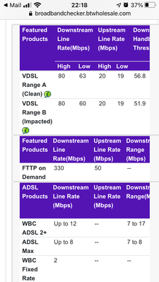

You must have a phone number even if you don't use it so results from the dslchecker link I posted would help see what speed range is expected for your line
Any speeds quoted by BT are connection speeds to your hub and not download speeds to your device

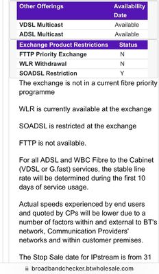

You've cut off the exchange and cab number.
754 Views
Message 9 of 16
Re: speed issue outside home
Cabinet 9 Fraserburgh
