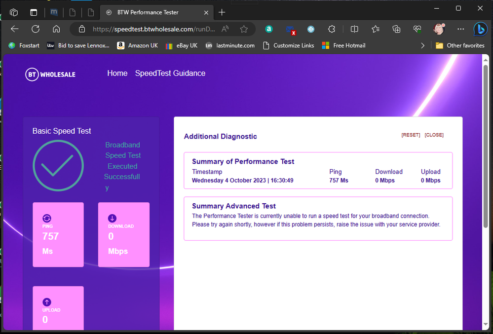

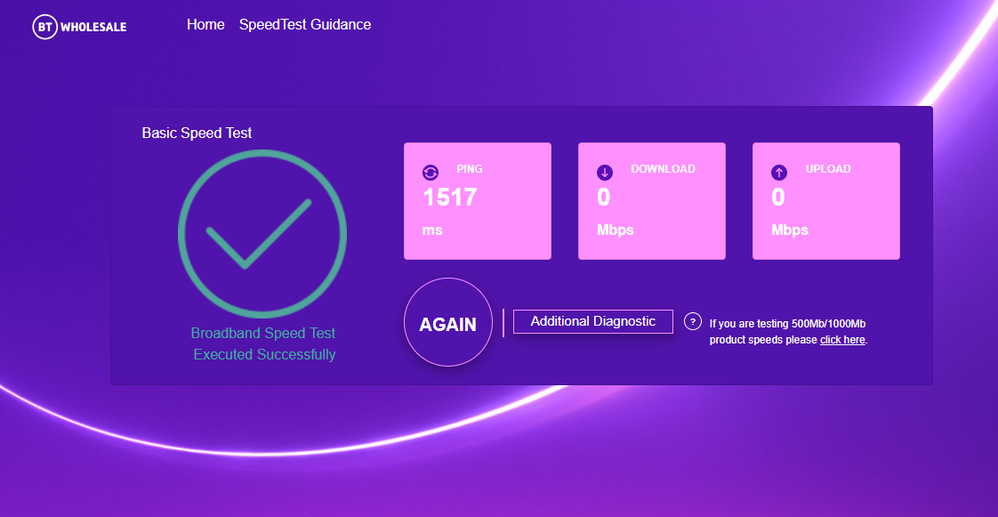

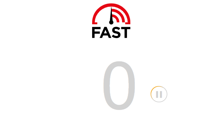

I bought new RJ11 and RJ45 cables and I have just connected them to my router and the test socket and have taken a variety of speedtests with my supposedly faulty laptop.  Before last Thursday I was getting download speeds of 17 and 18 and I do match commentary for Andy Murray Tennis Fans and often I was told that I was quite a bit ahead of other people with my scores!  I have been very pleased with my service.

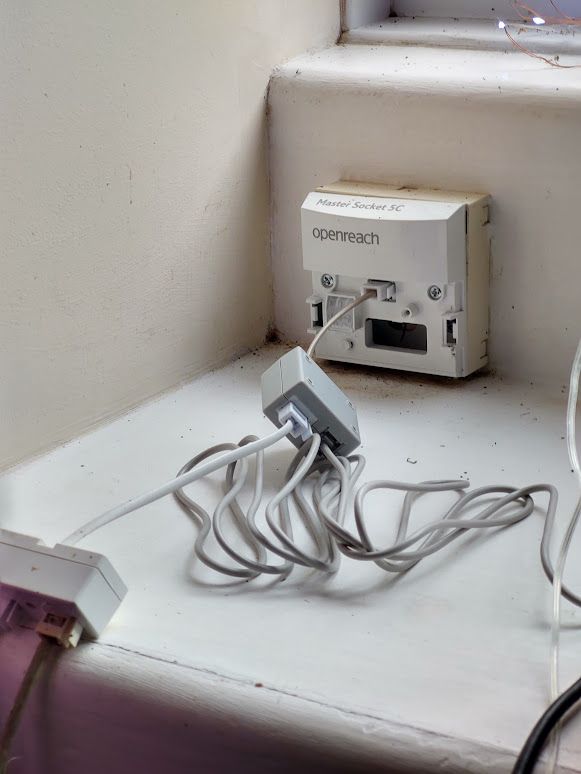

AD BTSPEEDTEST 04102023.PNGBT SPEEDTEST 04102023 TEST SOCKET.jpgBT SPEEDTEST 04102023 16.06.PNG
I did take some more photos that were all like the first one showing 0 download and 0 upload!  I've kept it plugged into the test socket in case it improves!  I took photos with the phone connected and without and it made no difference.  My landline is working perfectly.  Any ideas what I can do?

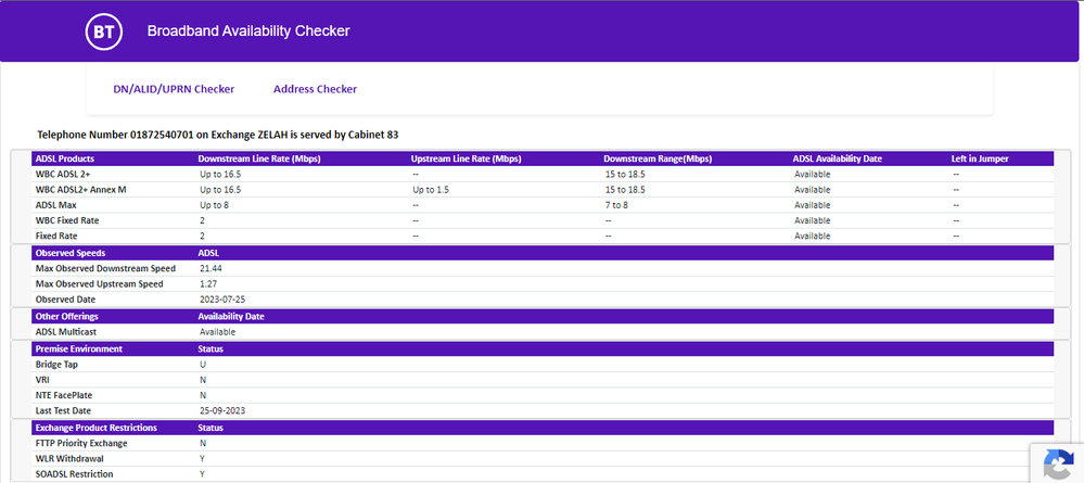

Post the return for your phone number , or if on Digital Voice use your  address to see the predicted speed for your location .

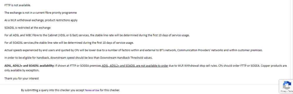

I've photographed the results of what I should be getting and for the last two years I have been getting that.  I don't know how to do the second part of your reply.  I am 72 years old and not very technically savvy.  Any help would be great!  Sorry to be a pain in the **bleep**!

@judymeg
Please delete your phone number from dslchecker as this is public forum and may lead to lots of spam
according to dslchecker results your expected speed is 16.5mb but it shows that on 25/5/23 your connection speed wa far better at 21.44mb

If you don't have an ADSL filter & don't know how to plug into the test socket, why is there an image of an ADSL filter plugged into the test socket in you first post?

As can be seen form the Checker return your line at the end of  July was actually performing better than predicted, TBH , at over 20Mb on an ADSL connection, you must be very close to the exchange.

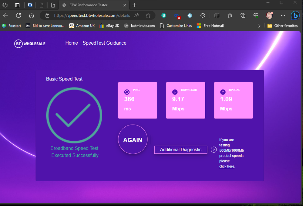

The router stats would be helpful , but taking the speed test info , obviously something has happened between the end of July and now , to account for the speed reduction from 21MB to 9Mb.
The photo posted shows the master socket test port with an ADSL filter plugged into it , you should try another filter , but before that , plug the phone into the test port , dial 17070 and take the quiet line test , there should be no ‘noise’ ( crackle, pops , bangs etc ) if there is report your line noisy, if it’s quiet , then plug a wired device ( like a laptop ) into the new hub, and the hub plugged into a new filter in the test port and run a new speed test …but it would be better to see the router stats …( advanced settings )

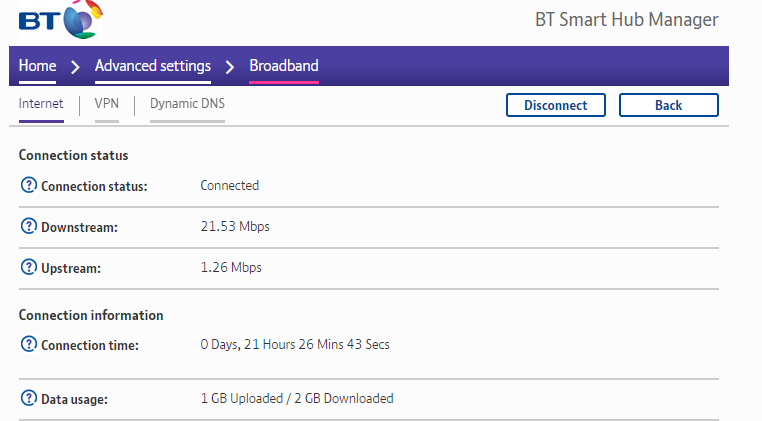

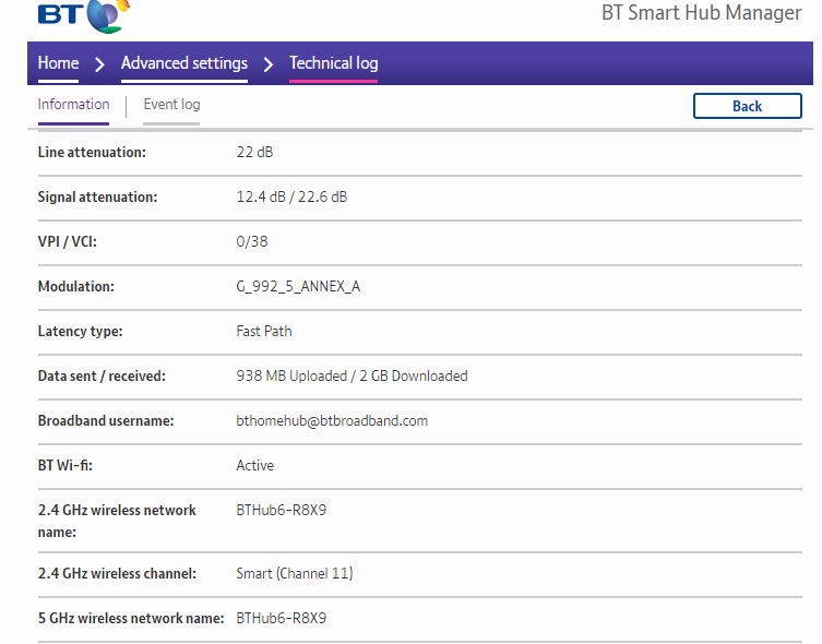

I managed to get into the hub with my laptop and have taken some photos!  I don't know if these help at all!
BT HUB SETTINGS 1.PNGBT HUB SETTINGS 2.PNGBT HUB SETTING 3.PNGBT CONNECTION STATUS.PNGTaken yesterday at 16.10Taken yesterday at 16.10Taken yesterday at 16.20Taken yesterday at 16.20
