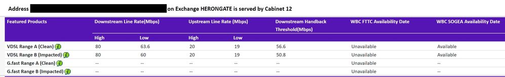

The exchange & cab info is after the address as below, but the entire VDSL section is missing for your address. Never seen that before if that's really what you're seeing?

Yes it’s not there at all! I haven’t cropped that section it just doesn’t exist! 🙂

@RedSquirrel
As has already been mentioned, you have missed the name of the exchange and the cabinet number from the top of your address and next door.
If there is just an exchange name, and no cabinet number for your address, then you are on an EO (exchange only) line, and only ADSL is available.

Sorry I misunderstood the part about cabinets!
Yes after checking again for my neighbour it states 'on Exchange name of town is served by Cabinet 1'
My address states only 'on Exchange name of town'
Sorry completely missed this!
