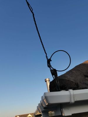

  • Further Checks: No internal sockets or extensions have been altered.  However, since my initial post, we have physically inspected the exterior network boundary at the roofline where the engineer re-attached the line.
I have attached a photograph to this post:
The Openreach drop wire has simply been twisted and wrapped in standard electrical tape rather than being run as a continuous, weatherproofed line.
Furthermore, it completely lacks a mechanical drop wire clamp. The line is visibly slack, meaning that it sways heavily in the wind, putting direct mechanical strain on that taped joint. It is entirely logical that this exposed splice expands and pulls apart during hot weather, directly causing the 20+ daily dropouts in the present heatwave.  Even in normal weather, we lose connection daily - just not as often as currently.
Any advice or ideas from fellow customers would be most welcome.   Thank you.

It would appear to me that the problem is as you have stated about the join etc with the dropwire and it should in my opnion be the first port of call for Openreach to replace and have it afixed correctly to the property. Once that has been done then should there still be a problem, further investigation needs to be carried out. Until that is done I fail to see how Openreach can start to say the problem lies else where.
Unfortunately I suspect there is nothing that any of the forum users will be able to do to help other than to comment on what Openreach have done or should have done.

Thank you very much for your assessment, @gg30340, and for taking the time to reply. I am glad to hear that you agree that the dropwire installation is the clear starting point for this issue; it is reassuring to have that validated.
Your advice regarding emailing the CEO's office to reach the Executive Complaints Team is incredibly helpful.  We will ensure that the photographs and the history of the botched installation are included in that correspondence so that Openreach can finally be dispatched to resolve the physical line properly.
