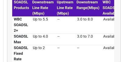

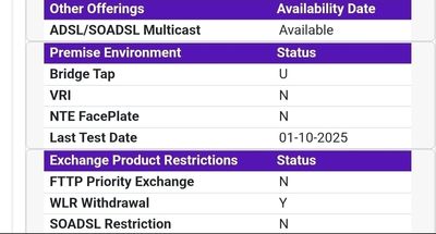

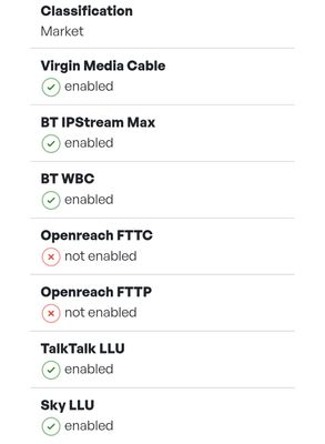

For clarity here are the results of a few checks on the exchange.
Don't appreciate some of these comments - we contacted BT before Christmas who told us they could cancel the broadband cease, Sky repeatedly told us the order was from BT when speaking to their 3rd party cease team 3 times and that they couldn't do anything.
At no point did anyone from Sky or BT explain that the phone/broadband would need to be with one or the other.    If they had explained this maybe this would be less of an annoyed post.
