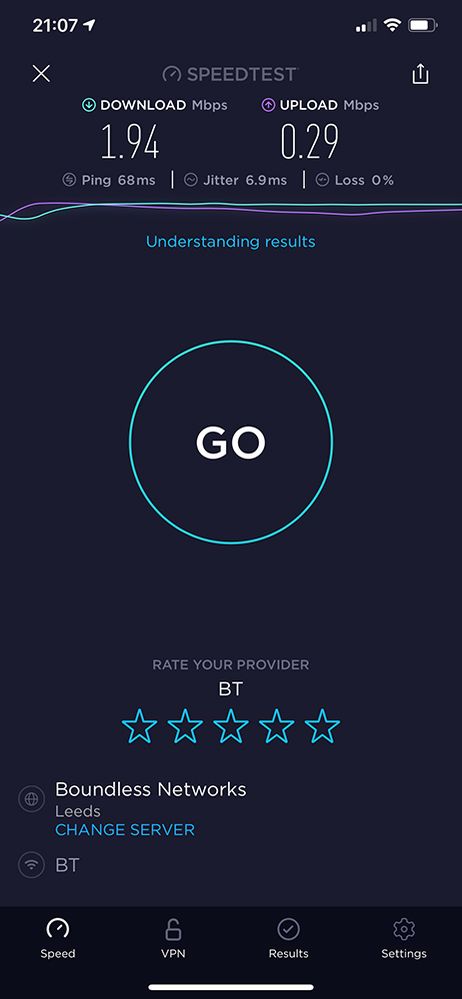

Now Tuesday evening and our connection has just dropped around 20:15. The hub yet again is flashing pink/orange then blue for 10 secs, back to pink/orange .... This is driving me nuts. I have run the quiet line test while in this state and no noise at all. Help?
