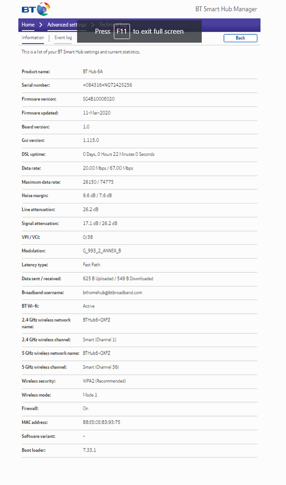

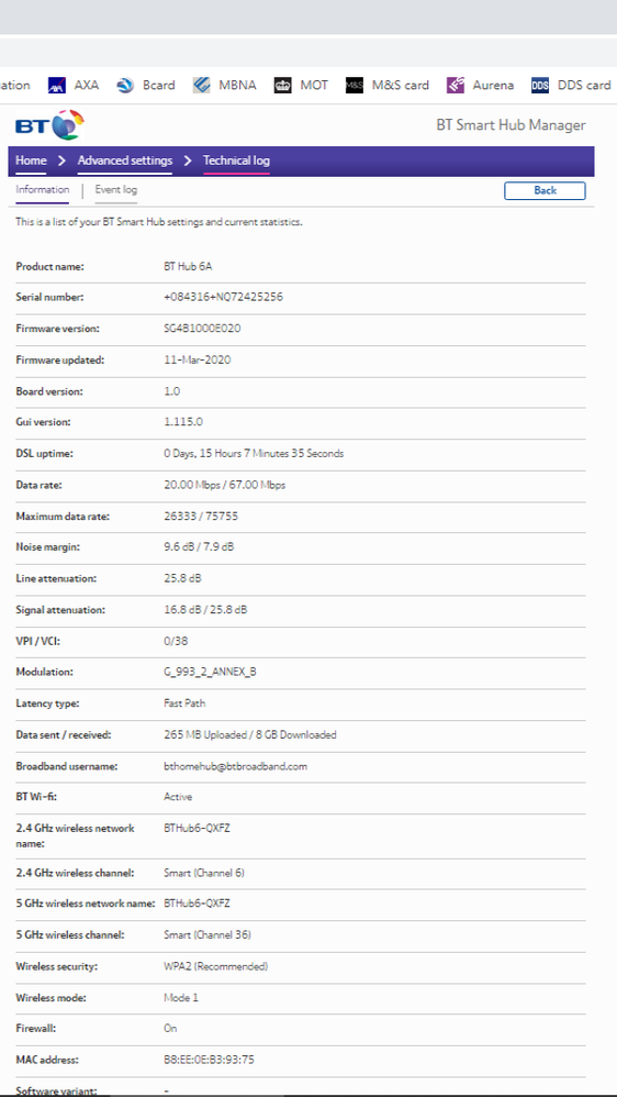

the last engineer has certainly fixed something when up pole.  your attenuation was 40db and after engineer down to 26db and attainable previously was 44mb now up to 75mb.  unfortunately with all the work and drops in connection you are in banded profile at 27.4mb.  this should correct itself automatically provided you maintain a stable connection

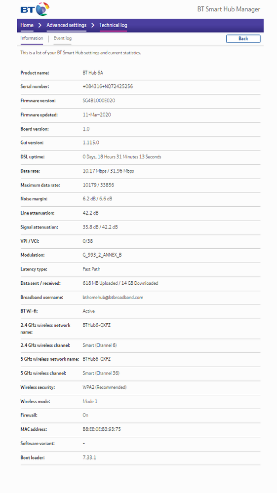

So I had to raise yet another fault.
From Saturday, Hub details below, when I thought it was on the way to getting sorted
Then that night it was back to ~ 30 Mbps again, and whenever the phone was picked up. it was very crackly and that seemed to stop the internet working, as we lost connection and hub lights went through their routine.
I tried to be optimistic, telling myself it was part of the procedure after a fault.
But next morning, and still today, We now have no dial tone on the phone! and these hub stats below
BT tell me fault will be fixed by Friday......... we'll see 🙄
If not, I will probably raise a complaint, no idea what good that will do though.
