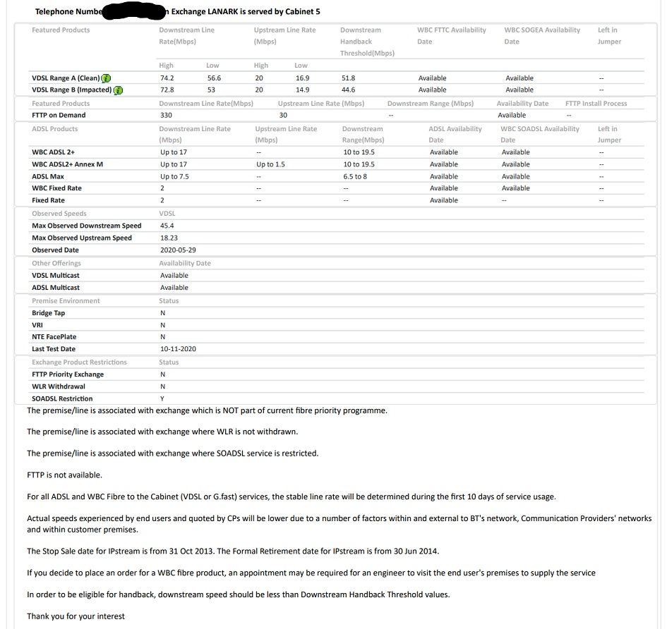

in order for the forum members to help please can you post the stats from your router (if hub enter 192.168.1.254 in your browser) and if  HH5 then go to troubleshooting then helpdesk and if HH6/SH2 then advanced settings then technical log information .
enter your phone number and post results  remember to delete number   https://www.broadbandchecker.btwholesale.com/#/ADSL
Someone may then be able to offer help/assistance/suggestions to your problem

Thanks for the reply imjolly.
Technical log from the hub and wholesale info below; FYI the DSL uptime is normally a good number of days, we dont experience dropouts in service (touch wood) and im assuming this was maybe an update through the night.
Wholesale DataWholesale Data
