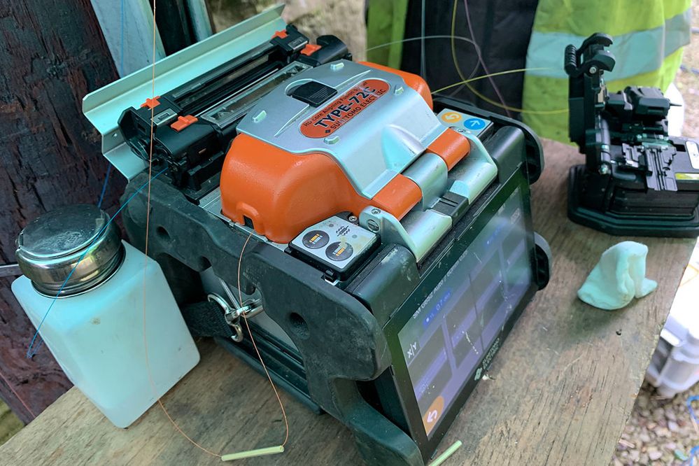

I know nothing about splicers but this is what the chap did ours with.👍

I kind of hope that's a salt shaker on the left and he was rustling up Margaritas!
