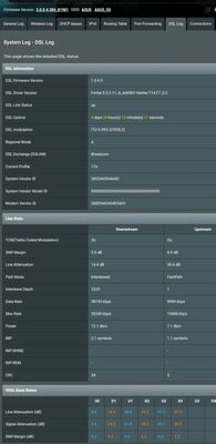

Moved into a new property and have just had my BT Fibre 1 transferred & enabled. I've kept my ASUS DSL-AC68U in use, though I notice the attached stats show quite heavy interleaving at present and no G.INP (at least so far).
My question is that is there any benefit to going to the Smarthub and whether my line interleaving is likely to improve?

Can't think of any benefit in moving back to SH2
your connection time is short was that due to just being setup of have you been making changes with router off and on?
you need to maintain connection and if your cab is G.INP enable then you will get boost after 7/10 days stable

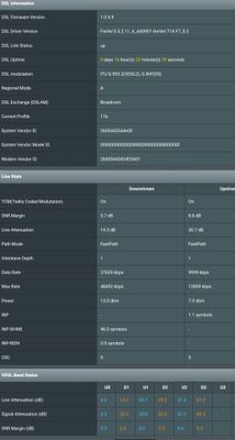

Looks like the line changed profile in the early hours based on the uptime. It has switched on G.INP and FastPath too. I guess this is pretty much the max I'll get from this as I'm not near he cabinet.

If your line is very stable then the SNR could drop down to 3dB giving you a few more meg on the downstream.
My AC68U holds steady at below 3dB , even down to 2.2dB at times.
The modem will not have both activated - G.INP may be applied when you have interleaving on (it reduces the delay caused by interleaving the packets) - you are on FastPath so no interleaving is applied.  I believe OpenReach disabled G.INP support for modems with Mediatek chipsets like the Asus DSL-AC68U some years ago.  I used to use this router but once OpenReach gimped its performance I changed to a Vigor 130.

I hadn't realised they'd disabled it for certain chipsets. I thought my line had it enabled based on it not showing under DSL modulation in the router one day and the appearing the next. If I thought it'd be beneficial I'd consider trying with the Smarthub

I'm inclined to think that G.INP does work as the router does state that it has a G.INP connection and from my experience it does seem to get a better connection , speedwise, when it says it has a G.INP connection.
Regardless of that the Asus gives you far better stability and functionality over the SmartHub and no external BT users getting a connection whilst allowing you to access BT Wifi when out & about. Also the Asus mobile app allows you to see what's going on and if necessary make adjustments when you're not at home.
