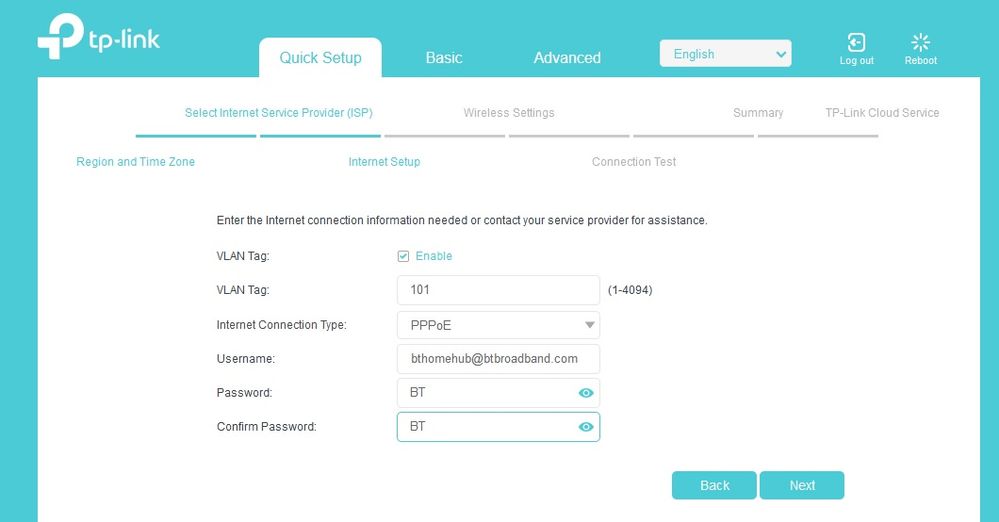

Re: Adsl to fibre 1 changeover.
Go to solution
@mike101 Just had a quick look at the online Emulator. If it doesn't auto detect BT VDSL, use 'Other' and these settings.
