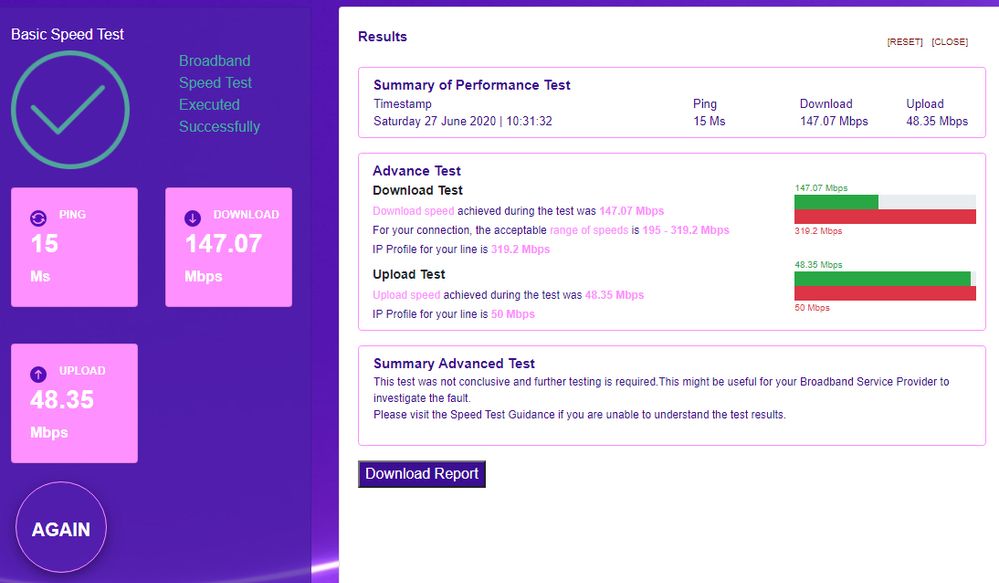

I have Fibre 250 with Halo2 and my minimum speed guarantee is 150Mb/s
The router is currently connected with a Data Rate of 328Mb/s but the max download speed I can download from any speed test site including BTs is just under 145Mb/s.
The BT Wholesale test site says my IP profile is 319.2Mb/s.

Thanks for the replies. The BT Wholesale test says I should be getting a faster download rate than I am which makes me think that there was a cap for Fibre100 that has not been changed for the Fibre250 upgrade.Test ResultsTest Results
