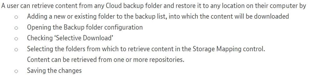

If you want to put the files backed up from the first device onto the laptop the simplest way is to use Selective Download. Then use the Cloud directory to transfer changed files.
