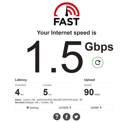

Forget Wireless for getting maximum speeds mate, Wired is where you should be looking.
Have you tried setting up a PPPoE connection dismissing the router for problems.
Probably try another laptop or similar because the bottleneck could be your computer.
If you are using the supplies Home Hub 2 you will never get near the speeds you are paying for.
Look at purchasing a decent third party router that has (AX) WiFi-6 for getting the best from your package.
I purchased an Asus RT-AX88U (expensive I know) but had maximum speeds and never dipped since I had FTTP installed.

Re: BT Full Fibre 900 - getting 450 (wired) at best!!
 huh!? Some kind of bug?
