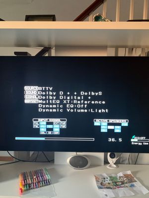

When connected to my Yamaha HTR-2071 receiver (in STRAIGHT (pass-thru) mode) watching a 2.0 source on a 'BT Sport 2' programme, the audio is distorted because I hear the presenter's voice in my rear channels.
The Box Pro is connected directly to the amp using HDMI.

Connected with HDMI to a Denon AVR-X1200W with Dolby Atmos setup and the channels that are Stereo (BBC1/Sky channels) is being output as 5.1 to the amp which mixed by the box puts the voice in the surround speakers.
The T4000 shows DD 2.0 and DD 5.1 as well as DD+ as the input (signal) on the amp when set to surround and all works fine.
