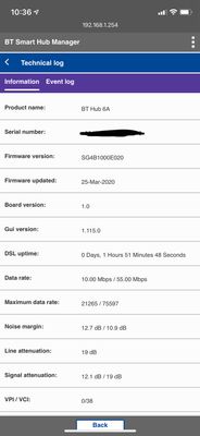

in order for the forum members to help please can you post the stats from your router (if hub enter 192.168.1.254 in your browser) and if  HH5 then go to troubleshooting then helpdesk and if HH6/SH2 then advanced settings then technical log information .

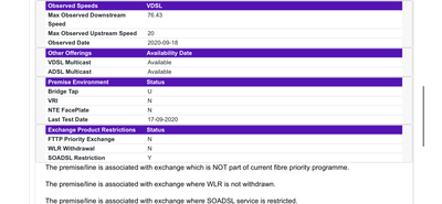

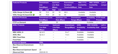

Is this what you wanted? 

the dslchecker shows you had a 76/20mb connection on 18/9/20 and with that you would have a noise margin about 6db.  you now seem to have gone back to fibre 1 with 55/10 mb connection speed and as your connection speed is well below attainable you will have a noise margin in excess of 6db probably about 12/10db all of which is normal
have your tried using the test socket to eliminate your internal wiring and master faceplate from causing the drops in internet connection?  have you tried a factory reset of hub to see if that helps?  remember if you do then turn off smart setup when hub reboots
