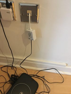

Hi, We recently moved to new house and I have got a new BT Fibre 2 connection. I have noticed that my BT main hub is actually near the entrance and I am not comfortable keeping it there lying on the floor.

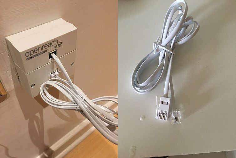

So I bought a BT plug to RJ11 plug as shown in the image and connected them. And then I have connected BT broadband connection to one of the phone line which is present in the living room with the help of BT's DSL472. Internet works fine but has drastically reduced the speed.
Download Speeds has reduced from 56mbps to 34mbps and upload speed from 18mbps to 1.5 mbps.
Is it the problem with the inner wiring in the house or is it something I can work it out. Please help

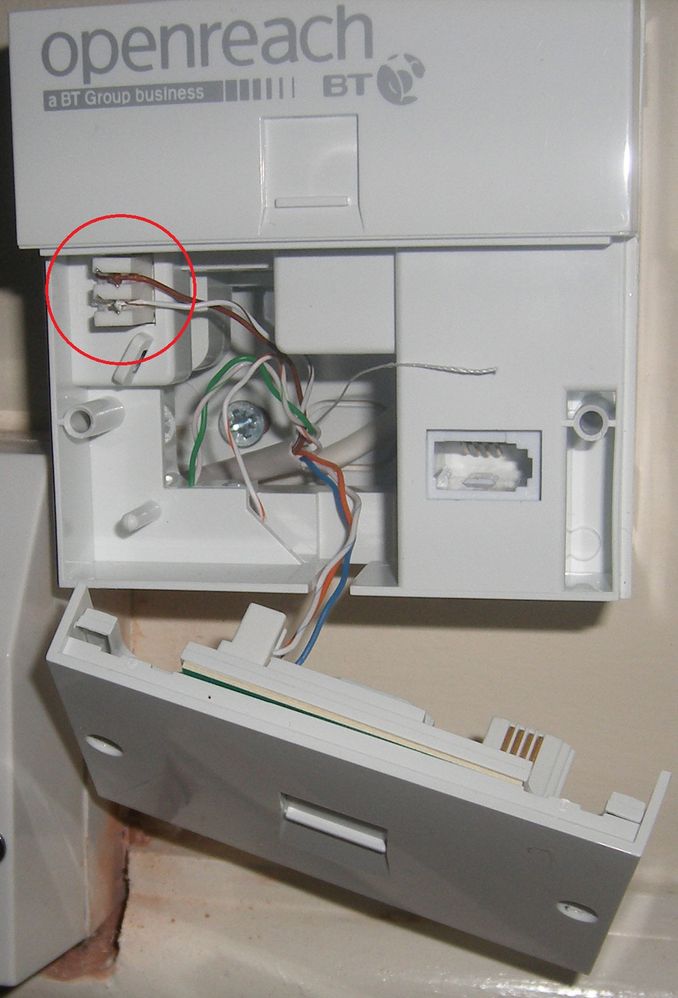

Remove the cable linking the 2 sockets, disconnect the 2 wires in terminals 2&5 of the faceplate and reconnect them to the data extension terminals.
Do you have more than one extension socket in the house?

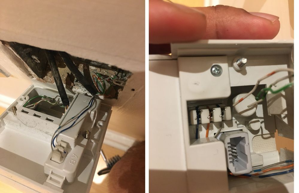

I guess Blue pair is coming in which is connected to A B, and Blue white - orange - Blue is in 2-3-5. This is in the master socket. How do I go further?

The first thing to ascertain is where the cable that is connected to terminals 2&5 goes to, whether it is to the extension you want the router at or another one.
 If you remove the lower faceplate of the master rather than taking the whole socket off the wall, you should see the data extension terminals, move the wires from 2&5 to there using a proper tool rather than trying to wedge them in with a screwdriver.

Yup it worked. Now I have replaced those wires. it works like smooth.
