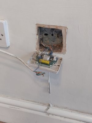

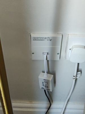

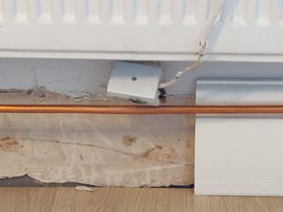

Hi,
Looking for some advice regarding my current wiring. I have what I thought is my master socket in our front room (has BT openreach face plate) but I soon realised our drop in comes from the back of the house. My drop in clearly comes into the house through the dining room. There is an old style BT junction box which then extends off to a standard plate telephone socket on the other side of the room. It looks like there is then a further extension off this that goes to what I thought was my master socket. The issue I have is we are having building work that will break the connection between the old style junction box and the first normal plate telephone socket therefore breaking the connection to my "master". Is it best just to make a master BT straight from the old style junction box and then run all the telecommunications from the dining room and is this something I could have an independent do or or as it's before the master would BT do this?
Unable to upload photos as too large
Many thanks

@Tomg12
Who do you pay for your phone connection?
4,216 Views
Message 6 of 8
Re: BT master seems to be at the end of a series?
Go to solution
Broadband and line rental is through shell energy
4,199 Views
Message 7 of 8
Go to solution
Then you need to contact them and ask them to arrange a visit from Openreach, to sort out the wiring so that the incoming connection goes directly to the master socket. The external connection is maintained by Openreach not BT.
There would be a charge for that visit, they should be able to tell you what that is.
This is a BT Retail customer forum, and would not be able to help with this issue, as you are not a BT Retail customer.
