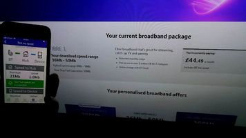

Ok so here's the rub. I have recently noticed that the speed of my broadband connection is much lower than the speeds I am supposed to be receiving. For reference this is the BT Fibre 1 with Halo 1 package that I am paying for
50Mb - 50Mb
Your download speed
Your Stay Fast Guarantee 25Mb   (note this has actually changed from 30 Mb down to 25Mb since I started having this problem see here: 20201102034427.jpg
Upload speed 10Mb - 10Mb
I have performed multiple speed tests over the past 2 weeks or so which all show consistent results of
19-20Mb download    1-1.25 Mb upload

The engineer visited and confirmed using his equipment that the landline was iin perfect working order, there are no faults with the cabling in the premises and also performed a speedtest on his own equipment which showed results consistent with the ones I had done. The engineer checked for congestion and confirmed that the local usage should not impact the speeds I am receiving. He also stated that he was changing it from (or to) 5Ghz from (or to)  the 2.4Ghz although I'm not sure this really matters as from what I understand this is simply the wireless frequency and my hub is actually connected to my computer via an ethernet and doesn't use the wireless. I might be reading that wrong and that may not be what it is but for the sake of clarity just know the engineer did this when he was here. This visit was on Monday and concluded with the engineer saying that he would escalate the issue and arrange for an Openreach line engineer to come out before Wednesday to check the line between the premises and the cabinet (which I actually believe is sitting directly outside my bedroom window no less than 20ft from the premises. I may be wrong but I've certainly seen Openreach engineers in that box.)
If you require any further information I will be happy to provide it.
My Speculation:
There's a toggle or slider somewhere on the BT systems which has not been set to reflect the speeds I should be getting.  The reason that I say this is because everytime I run the BT speed test it returns the speed at 21Mb and 1Mb and then says these results are "good" or within the expected ranges... which they are not. They might be if my account was still set to be receiving what was promised for my previous package but they most certainly are not for the package that I am on right now.

Your hub shows a conenction speed of 24mb with attainable of 24mb and with noise margin down at 3.1 suggests G.INP is active.  A download speed of 21mb is good and consistent with a connection speed of 24mb
i doubt you are going to get much faster on FTTC and I agree with @pippincp  phone FTTP and get upgraded to. FTTP and whichever package you prefer whether same as you have of even speed of 900mb
