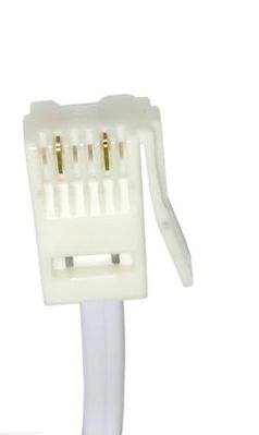

(Notice it only had 2 wires. This should be the lead coming out of the adsl filter that plugs into the adapter or phone socket.) 
Hi there,
for the 2500, my advice would be to check what type of adsl filter you are using. I was using an old BT one but had to change it, here’s why:
the problem may be that the 2500 doesn’t like the ring wire (I had a problem similar with an older BT Converse) so try and find an adsl filter that has only 2 metal pins on the plug that plugs into the adapter. As another reply suggested, you may need a ring wire added, but I would say maybe you need it taken away. (I’m sorry I’m not that technical but I’ll provide a photo of the type of plug your filter should have)
my BT filter plug had all four wires and wasn’t removing the ring wire, but then when I tried the 2 wire one, the Bt Converse started to work. The beocom 6000 still didn’t but that’s a different story. Definitely give it a try with your corded phone and let me know.
