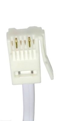

Going from experience of my own problems, the ring wire is probably the issue. This was also the problem @Jazzer71 had, but don’t worry, it’s easily fixed.
If you plug an ADSL adapter into your VM Hub, and then plug the Beocom base into the adapter, this should solve the problem,  as this will disable that “ring wire” I was taking about. Make sure it only had two wires on the BT plug (two gold prongs on the top). I will attach images of this in a separate post.

E98AF8F9-04E0-4AB2-8DE1-3DFD2680EB38.jpegNotice it only has two wires, make sure your ADSL has this type of plug on the end.
@Kiran
Regards
Ryan
