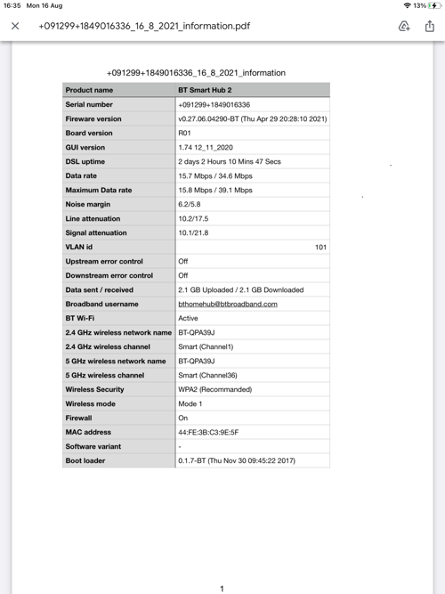

Could anyone help me understand something about my broadband. I currently have an open complaint with BT and to be fair, the representative is very helpful and patient but I just can’t get my head around the problem. In my simplistic terms, I have fibre to the cabinet halo 2. In the last 12 months I have had engineers out 4 times as we drop from having a line that can support 49Mb to supporting 34mb. I pay for a package of 35mb to 54mb and am happy when I can get late 40’s.
On the first 3 issues, an engineer came and after various things has left leaving me happy with 48mb enabling us all to work from home. Early July it went off a cliff again. Open reach have been again 3 times. They have replaced the main socket as a small bit of noice there. Checked my telephone line wire on the outside if my house and then the main telephone pole and said this is fine. The engineer used his tester and said that the line was receiving 48mb to his tester so suggested it must be the smart hub and also said that not having cheap land line phone plugged in would help so taken that out. I have now set up new smart hub and still only 35mb.
Bt have now said they can send another engineer but it won’t help as my line only has capacity for 35mb and therefore need to be on lower package fibre.
Question 1. How can my line previously get 49Mb and now only 36 ? And why does the engineer say that 48mb is coming into his tester ?
Question 2. My neighbour  who is further from the box is getting 48mb and also with BT ?
Question 3. BT can now release me from contract as not fixed issue in 30 days but would I have exactly the same problems with any provider as it’s the same line ?
They have agreed to send an engineer again Thursday if anyone has any suggestions as they seem equally as perplexed. I just don’t know why it would just drop 16mb in a week and not be fixable
thank you

in order for the forum members to help please can you post the stats from your router (if hub enter 192.168.1.254 in your browser) and if  HH5 then go to troubleshooting then helpdesk and if HH6/SH2 then advanced settings then technical log information .

Can you post the line stats from your hub.
Enter your phone number in the checker and post a screenshot of the result. https://www.broadbandchecker.btwholesale.com/#/ADSL

I have done the line test and all clear and uploaded photos which hopefully you can see 193B1949-E8A2-4751-80DA-429C1D17FE14.jpeg91854937-428A-4B2D-B357-18C1BED96333.png

Yes, we can see the pictures but there is one important thing missing. The exchange  and cab number.

Your speed appears low compared to estimated range so have you tried using the test socket with a filter to see if that improves your connection and attainable speeds
You appear to be on fibre 2 but according to checker you cannot Achieve fibre 1 max speed but may suit you as getting good up speed

Hello. I have had 3 engineers here and I had a filter in there when the last one came. He suggested I remove it and not use the landline as the phone can cause little errors. I will try it again in the morning and let you know. Re fibre 2 - I have been on this for 12 month ps and was receiving the average until early July and then it just dropped by about 15mb and the only resolution I can get now is that my line will only receiving 35 now not 49 and no solution so Bt can put me in fibre 1 instead which doesn’t resolve the problem.
This is why I don’t understand it but I will try the filter tomorrow. When you say the test socket, do I take the cover off ? Thank you

The problem could simply be crosstalk from a newly provided line.
