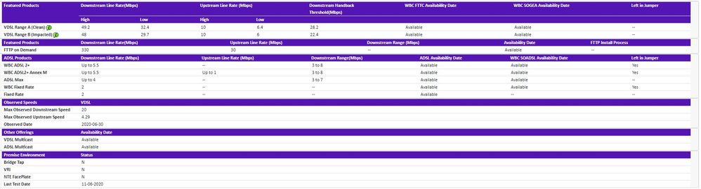

enter your phone number and post results  remember to delete number   https://www.broadbandchecker.btwholesale.com/#/ADSL
Someone may then be able to offer help/assistance/suggestions to your problem

Thanks for the reply. Pasted below an extract from event log, stats and broadband checker. Can't test the line I'm afraid as we don't have a phone (corded or otherwise). Really appreciate your help.
