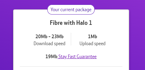

Hi,
I'm on a fibre package with BT (Fibre with BT Halo 1) that has been rated at estimated max speed of 40-50Mb for the last few years.
Suddenly (more or less overnight, I think), we're now rated at 20-23Mb max download speed - i.e. something upstream of me (cabinet or exchange) has changed and now this is the fastest I can ever expect.
This is...rather frustrating to say the least.
Can someone in the know tell me how common it is for BT to basically halve your connection overnight with no communication / warning? And whether I can expect it to return to the old baseline?
Given this new lower estimated max is what I am seeing on BT.com and across all the broadband / exchange check sites, I am thinking it's a deliberate downgrade due to capacity constraints, rather than a fault.
Thanks!

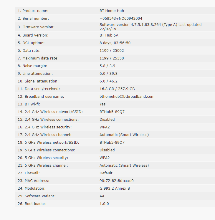

welcome to the BT community forum where customers help customers and only BT employees are the forum mods
in order for the forum members to help please can you post the stats from your router (if hub enter 192.168.1.254 in your browser) and if  HH5 then go to troubleshooting then helpdesk and if HH6/SH2 then advanced settings then technical log information .

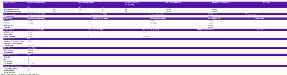

Many thanks! See below for router / exchange info.
Max estimated speed from most providers now seems to be 20Mb. It has been 40-50Mb for years, so I don't know what is driving this.
Router infoRouter infoConnection / Exchange InfoConnection / Exchange Info

This is now what I'm told my guaranteed / estimate is, and is in line with speed test results.
Never had any problems with my connection previously, which was always 40-50Mb in line with previous guaranteed / estimate.
