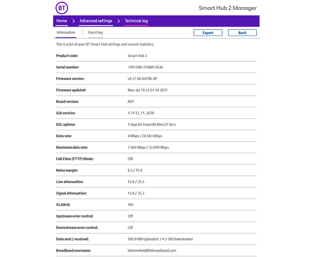

Ive tried leaving the router several times for long periods of time. The last one was 11 days and after a reboot it still refuses to come back to the 6/30Mbs we had at 6dB/3dB, for a very long time
Is there anyone that can assist in how I could request a DLM reset please, as it looks like the link is very stable. Alternatively could it be the router that has been affected by the numerous power outages?
Id be very gratefull of any help

10/11 days is not long enough for DLM to start to see your connection stable and start to improve connection speed - more like 3/4 weeks at least
was the reset 11 days ago a manual reset or router dropping connection?
3,730 Views
Message 7 of 7
Re: Broadband problem after multiple power failure
Hi, thanks for coming back to me. Yes the rest was a manual one.
I notice that when it reconnects the max figure is lower, so setting the actual speed, then after a few minuets the max speed increases to the 30+. Is this indicative of anything, or just the fact that as you say it may need several weeks?
