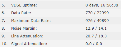

Just looked up the stats on the router: These are the sorry looking figures:

Hi, thanks for the reply.
I did a line test this morning and it was quiet, and did not cause the Home Hub to drop out. However the stats on the router show it did restart (again) last night and my various figures are still low:
I will try again later (back to a fun morning of back to back Zoom calls until lunch!).

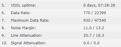

Hi, just took another quiet line test and no noise and no hub drop out...
The router stats now show:

If you cannot maintain a stable connection then your speed is never going to improve and may get worse.  You need to phone BT 150 and get engineer visit
