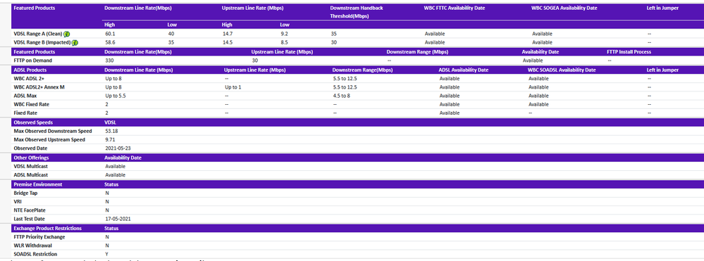

The BT hub always has the data rate and max data rate fields set to 53-55/10 - even during the overnight issue.
So within a Mp/s - the following are the same results everyday for weeks - without fail.  These speedtest are done from a different ISP to retain the fact that no devices are conneted.
If I connect the computer via Ethernet or WiFi then Ookla test gives same results witin a couple of Mb/s.  The upload speed is never an issue as is always 9-10Mpbs even during the slow download.

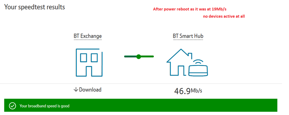

can you run btspeedtester with ethernet connection when download speed appears ok and then again when appears bad and post both set of results

The speedtest were originally done when connect to the hub - I've just gradually removed stuff since the issue and switched them to a different ISP.  Had some WiFi and Ethernet devices  on BT but the speeds have never changed within 1-2Mb/s.
I've checked the availability checker during both slow and normal times - and the results never change beyond 1-2Mb/s.

This is a log showing everything from being at normal speed (48Mb/s) - dropping to slow (19Mb/s) and rebooting back to normal speed at about 8am. I've removed a lot of CWMP references to shrink to size.
