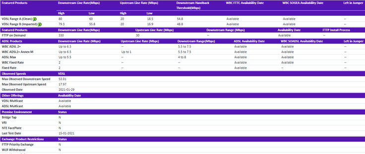

Why've you posted the checker results again? The hub stats would be better.
From the stats in your first post it lookss like you've been provisioned for Fibre1. What does it say in My BT?

Looking at dslchecker the connection speed is 58/17mb so to high to be fibre 1
Connecting to test socket and reposting hub stats would be helpful

Here are the hub stats whilst plugged in to the test socket (apologies for my previous misunderstanding/misreading).

@imjolly  I missed the upload.😵
