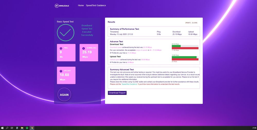

Hi, hoping to get some help here regarding an issue I've had for a few months now.
I am on the Fibre 2 package which throughout the morning and afternoon gives me the correct 60-70Mbps download and around 18Mbps upload which is good. However since around the end of March (The time which I first took it up with the BT Twitter support) I have noticed every evening past 8pm I have used the internet I am getting a tonne of buffering and lag in online games. I ran a bunch of speed tests with the link they gave me and I'm averaging anywhere between 25-35Mbps on a wired connection. The WiFi is around 10Mbps. In an attempt to stop lag I'm having to switch the ethernet cable back and forward between my PC and console as I'm normally gaming around this time in the evening or watching streams however it is still noticeable.
I don't have a single drop out or connection issue throughout the daytime at all, it's only at the point 8pm comes around that I begin to notice issues.
After going round in circles of different advisers on Twitter I figured I may have a better chance here, they only seem to run tests for me mid-day when it's all fine and don't take in to consider the multiple times I've told them the issue is only past 8pm in the evening.

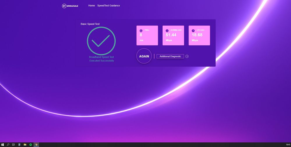

I have posted my recent Speedtest here, I have a few from previous days and some tests I ran before 8pm showing that all is fine before.
Any help would be great thanks as I feel like I'm not getting my moneys worth for the service I pay for when I want to use it most.

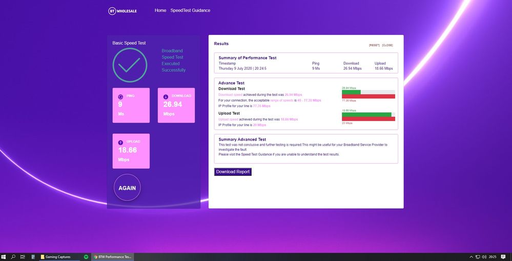

I can post results I took from 9th July, however if you need a fresh set via the diagnostic I will do another set tomorrow afternoon + evening.

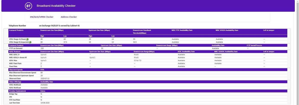

These are the results from the phone number check, the bottom section of writing is cut off due to the file size being too big to post, let me know if you need to see that also;

Don't worry about the bottom of the checker being cut off you've supplied the info necessary. Someone will ask one of the mods to check for congestion at the exchange and one may post here for further info if needed.
