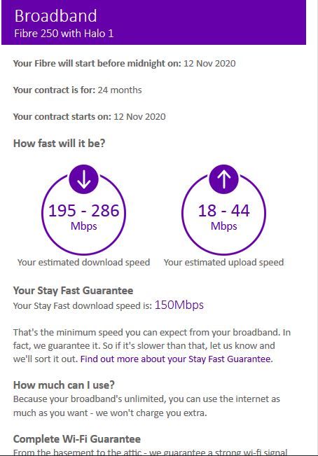

I have no clue, that's why, I am checking to see, what is actually going to happen with the engineer.
Its the speed service in the picure is what I have signed up for, but no clue about anything else.

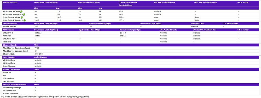

Both FTTP and G.Fast are the technologies used to deliver the 250Mb service. To find out which, enter your phone number HERE and post the result. Remove number before posting.

Thanks for all the replies so far,
I have added another picture based on the link sent eariler.
Cabinet 63 is close by and here is some of the figures.
Looks like, Gfast as that seems to be mentioned a few times!
Hopefully this might answer the questions I have.

FTTP is not available, G.Fast is, ergo you are getting G.Fast.
