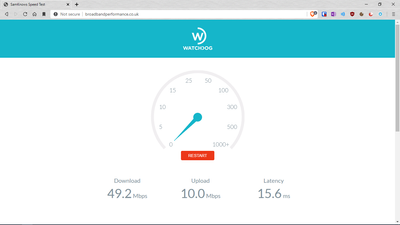

My router (and BT) I have had for a year has always shown the Download Sync Speed as 55mbps (download) and 10mbps (upload). This gives me speeds in my home as 49.2mbps and 9.5mbps respectively.
During the nights over the past year, the router seems to 'reset' itself occasionally but always returns to the above speeds.
However, for the past two days the router is showing 49mbps (download sync speed) but the upload has stayed the same at 10mbps upload. My internet speed as dropped to 42.4mbps in my home.

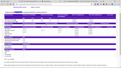

Can you post a screenshot of the hub stats and a screenshot of the DSL checker https://www.broadbandchecker.btwholesale.com/#/ADSL
Remember to edit out your phone number in the checker screenshot before posting

55Mb sounds like the package you are on , what is the max attainable rate shown in your router stats ?, your throughput is always less than your sync rate , but if your throughput used to be better than it is now, and your sync rate hasn’t changed , perhaps you are on a congested VLAN , try off peak times to compare.
Any speed tests should be on a wired connection, if using ‘wireless’ , perhaps someone nearby has switched broadband provider , or just got broadband, and their new ‘WiFi’ is affecting yours.

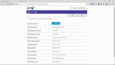

Hello, these are the two screenshots 'before and after'.
I have screenshots from most of the year showing a 'normal' 55mbps download speed. It is only recently that the download speed has changed to 49mbps.
Mant thanks.

Can you post a screenshot from the full stats page please, rather than just the status.

Hi, all throughout the year I have been with BT my router speed via this method has always been 49.2mbps (download) in my home as the down load sync speed is 55mbps. I am aware of those details (hardwiring etc).
I have kept the same testing method (occasionally using Ookla) but on the whole I use this service. That is really not the point here I am asking. It is why my internet speed has dropped from 'pole (or cabinet) to router rather than whatI get from router to appliance within the home. I am aware that that figure will be lower than 55mbps - which as I previously stated is 49.2mbps.
The above screenshot is what I tend to get from various 'checkers'. I know it is not 100% correct in line with 'hard line' checking but it has remained consistent throughout the year.
I am now getting 42.2mbps or thereabouts. What I am asking is why?
