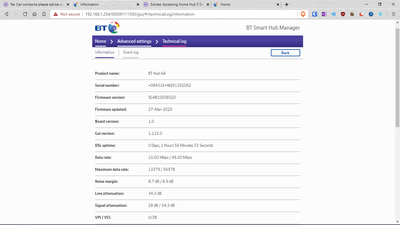

Hello, I am unsure of how to obtain the full hub stats. I said I did not have a noisy line. It is clear just a very slight static noise. I would not class that as noisy.
I can open the hub but where are the full stats located? I have a BT Smart Hub.
Thanks
4,350 Views
Message 12 of 20
Re: Can someone please advise over 'Downstream sync speed' on my router?
Go to solution
The line should be perfectly silent, any noise at all is a sign of a fault.
On the smart hub2 it is Advanced settings >Technical log > Information not sure on the SH1, be somewhere similar.

 Hello, thanks for the reply.  I am not sure I could report the line as not an emergency or classed as a vulnerable person.
Hope the details help.
Thanks
4,338 Views
Message 14 of 20
Go to solution
As you can see, your maximum data rate is about 57M and your line has been capped due to the fault.
