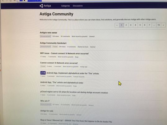

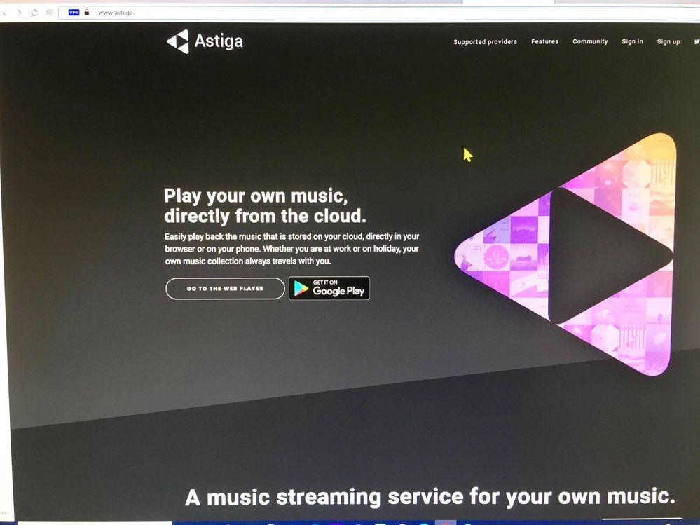

Strange! Over to our expert @Keith_Beddoe for this one. Having time on my hands, I thought I would try the said link! Same problem but then I tried Opera which has its own VPN.
This worked but interestingly for me anyway, the community site would only load when I selected it from google!
