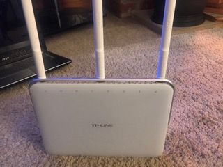

I think you are correct. I input the connection info and click save but it doesn't appear to do so! I'm using the tether app. Its the archer vr900 this one :
Connect to it using an Ethernet cable, as the tether app may not allow you to change any settings which could result in the Internet being disconnected.
If all else fails, try a factory reset, and then set it up via an Ethernet connection.

I will do as you suggest, thank you. I don't have a laptop with an ethernet connection so I have just ordered a USB to Ethernet adaptor so I will give it a go when it arrives and report back,

I received the adaptor in good time today and I have successfully connected via ethernet to the tp link router which allowed me to enter the info and importantly it saved it.  This did the trick, all back up working inc the wi fi until I plugged another ethernet cable into the smart tv and this stopped the router working again, wi fi went down and my sky q box reported no internet connection. I unplugged the ethernet cable from the TV and everthing worked again!! I have left the ethernet cable unplugged from the amart tv and connected it using wi fi, not my first choice but everything works ok like that. I thought the ethernet cable might be faulty but it works fine when tested with another device. Anyone make any sense of this issue?
