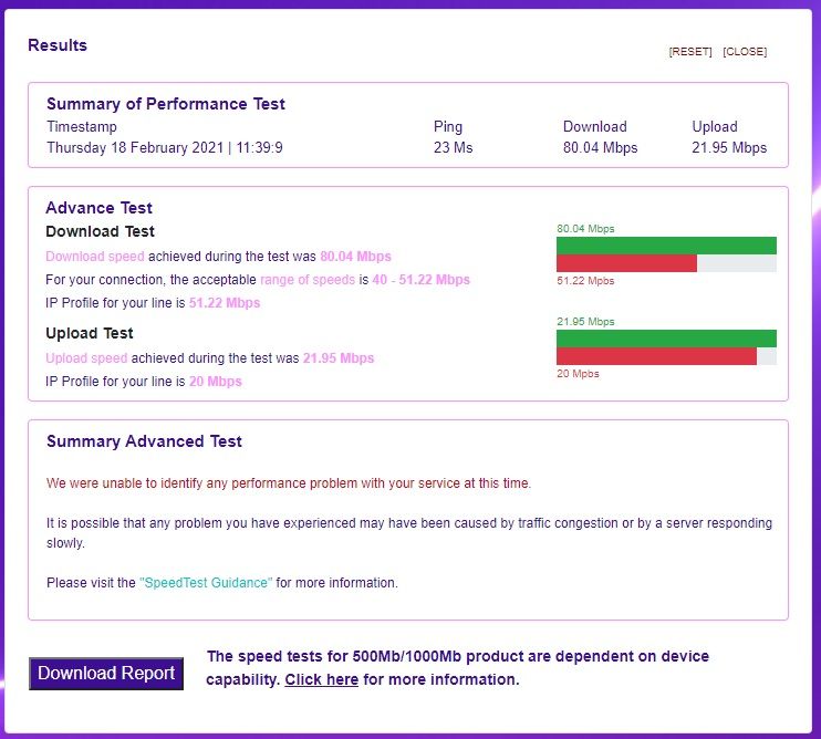

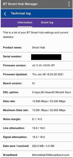

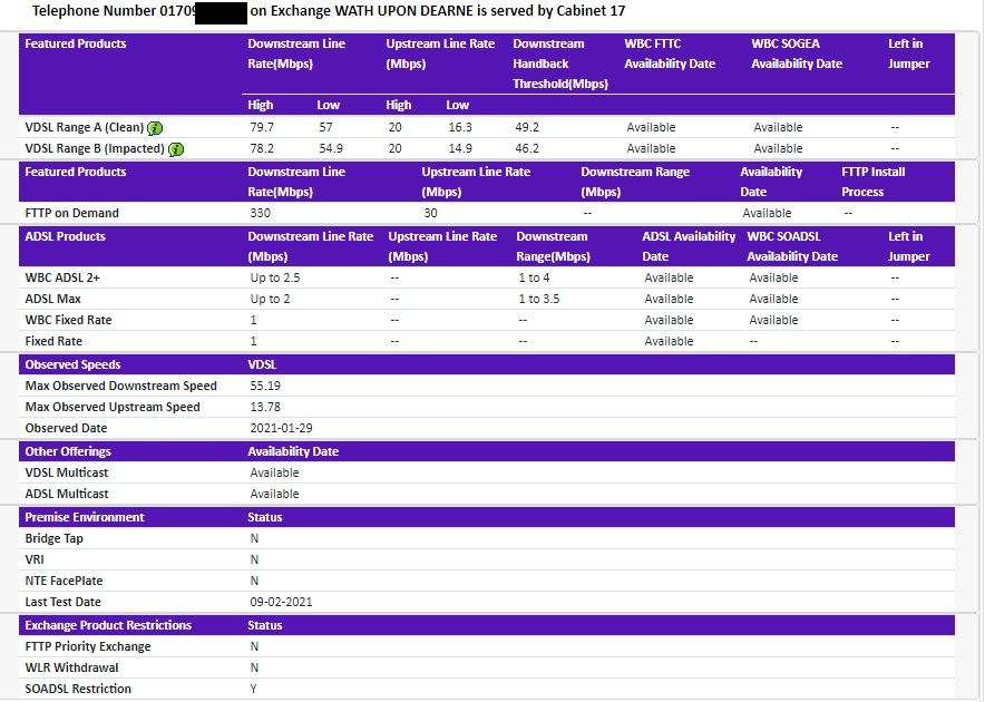

Could someone take a quick look at the attached images and let me know if my IP profile / SNR Margins /etc are all good?
Also just to note: on the wholesale speed checker, I did an advanced test on my correct phone number but remotely so the download/upload speeds are wrong.

from your stats you appear to have a fibre 2 connection with connection speed just above 55mb down but well above the 10mb up fibre limit   the 20mb up profile is fibre 2.  were you given a free upgrade to fibre 2 speed maybe 18/24 months ago?
your speed range expected is 79/57mb and you are just below that    are you using the test socket with a filter to see if that helps speed?
your connection time is very short are you having connection problems?

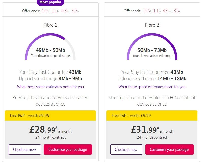

Hi, thanks for taking the time to reply.  This is my incredible frustration!  I am 100% on fibre 1 - at least from a branding point of view.  However, I noticed I didn't include the options available to me.  The first 2 images below are what BT offer me when I'm logged in.  Note Fibre 1 and 2 are both the same other than the cost! Same stay fast of 41mb, same estimated speeds.  However, look at image 3 which is in a private browsing window as a new customer using my address.  The stay fast is different and fibre 1 and 2 have expected large differences.
The engineer advising the 60mb sync speed with his equipment suggests I should be getting close to 60meg, but the whole fibre 1 vs 2, but with my speeds being above fibre 1 just makes my head explode! I feel like something is wrong here and I may be being artificially limited.  I'm IT savvy, but not with this and I don't know who to moan to frankly, or what to say to them to get my point across - if there is even a problem in the first place!
Connection time was just me trying to force a resync (i only do this weekly to ensure it doesn't look like line drops).  Stability-wise my connection is perfect at the moment, new cabling from front box to faceplate, brand new faceplate etc.  No difference between test port and front, and no extensions wiring or anything else connected to the line - just the smart hub.

the estimates of line speed are exactly as it says 'ESTIMATES'
you have better information as existing customer and with FTTC connection
whether you are on fibre 1 or 2 the estimated max speed for your line would be the same but line restricted to 55mb on fibre 1 and 80mb on fibre 2   The dslchecker for your line estimates speed range of 79/57mb with handback at 49mb
your max attainable is 55.6mb and you are at max attainable - there is no restriction of the the max attainable speed which ever package you are on

the max attainable is set by your distance from the cabinet and quality of line nothing to do with the router/hub being used.  you are on an ECI cab so currently there is no boost from G.INP and 3db noise margin
