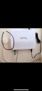

Hi,
I have FTTP on order and spotted in the Openreach guide that there is a case that holds the Nokia ONT and the cables neatly rather than on show in the hallway.  Two neighbors have just had their install and neither got the case / I chatted with the engineer and he knew nothing about them.....
How do I get one of the cases shown here: https://www.openreach.com/content/dam/openreach/openreach-dam-files/images/fibre-broadband/fibre-for...

the cases are only installed on Greenfield Sites, aka New Builds.
Brownfield Sites don’t have them installed and instead are just wall mounted and the EZ Bend Lead In Cable in protected/covered by an Internal Lead In Kit, it’s basically a round plug.
What’s in the circle is an Internal Lead In Kit. Ignore the ONT, that’s the old 4+2.

Thanks Starwire - that's a shame.  The kit has reduced in size over the last few years but it still looks a bit of a mess beside the front door 😞    Does Openreach not have anyone on their design team that is bothered about what things look like....
Another query  on neatness.  Why cant the EZ cable go out of the back of the CSP into the house rather than back down the wall and not in the trunking? https://tinyurl.com/a9tbuy9s

The ONT sits flush against the wall.
To try and hide the EZ Bend behind it would damage the Fibre.
I know because we had to revisit almost 30 sites to replace the cable and install it correctly where some idiot Contractor installed them like that and they all went faulty within 6 months.
