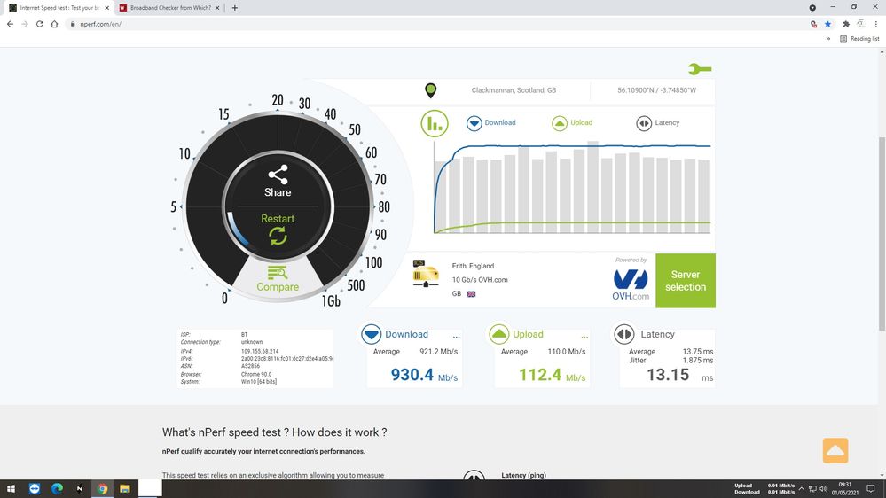

Just for the record and to show how unreliable and rubbish the which? test is, here are 2 screenshot of speed tests done on Nperf and Which?. This is the best I managed to get on Which?, all other tests were even worse...
