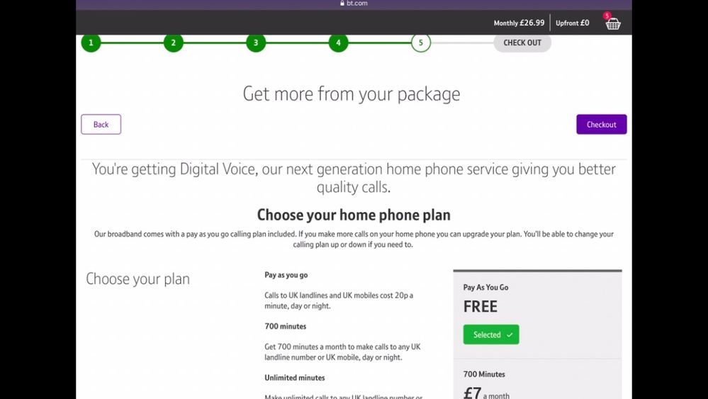

But when I go through the order process on the bt.com website I see this text regarding phone service:
 “You’re getting digital voice, our next generation home phone service giving you better quality calls” and then the offer of keeping existing phone and plugging it into Smart Hub 2, or getting Free 1x Advance digital phone or 2x essential digital phone.
This implies the copper line will be retired?

I'm not sure what the criterion is for deciding whether voice is provided by existing copper or Digital Voice (VOIP) for FTTP installs, it doesn't appear to be universally one or the other. Given that your order process specified Digital Voice, I suspect that is what will be provided in this instance.

I don’t get any options... “you’re getting digital voice” it says whether you want it or not 🙂
