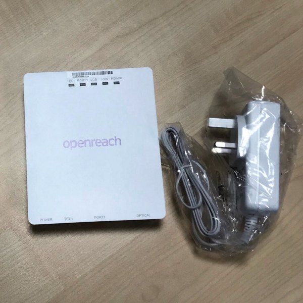

You will have something like this if you have FTTP.
If you don't have that then you have FTTC and you cannot disconnect the openreach cable from the master socket.
You should be able to either get a free digital voice phone or a free adapter for your existing phone.  The adapter plugs into a power socket and your existing phone will connect to the adapter.  If you wanted more adapters then you will need to buy them

Re: Confusion: Digital Voice and Old Phones
Yes, I have that white Openreach box: I have no idea what it does, I thought it was another Internet box like the BT Smart Hub 2. So what does this mean? I can rip out some wires from the adjoining Master Socket? Because the BT people said I should definitely not be doing this.
