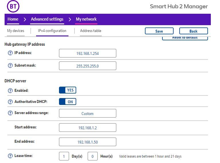

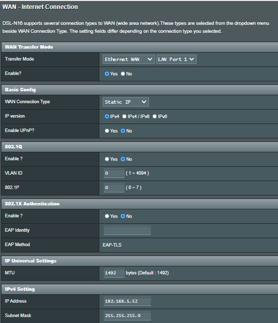

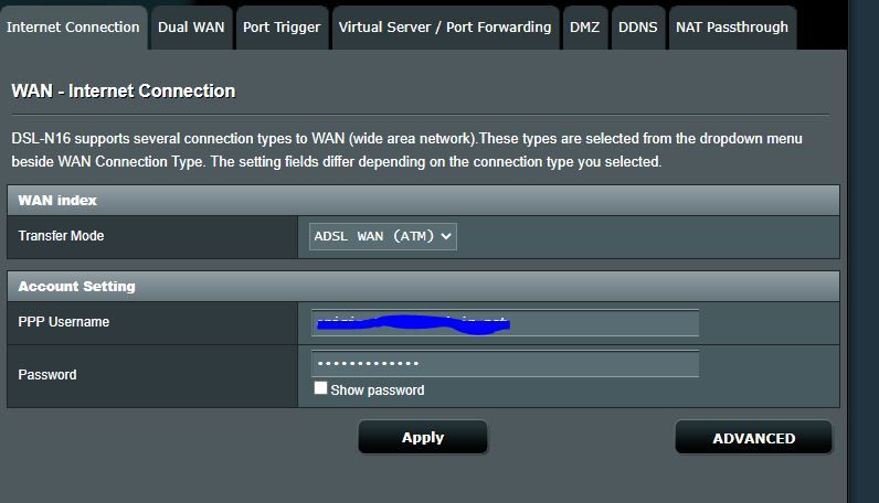

I followed below link for configuration but unfortunately my second router/network doesn't connect to internet. Any suggestions pls? The second router I am trying to connect is ASUS DSL-N16.
I provided screenshots of current settings of both BT Hub and ASUS

I don't have an ASUS, but there are a couple of things. What other options are there in the drop down for WAN transfer mode, ADSL WAN is wrong. Is there an option of Ethernet?
Is there a setting somewhere for gateway address? If so, it needs to be 192.168.1.254

The only other option available for WAN in dropdown menu is VDSL WAN, would that be correct?

You could try it but it shouldn't be either as you are just connecting to another router rather than a DSL signal. The hub will be taking care of the PPP details.
What other options are available for WAN connection type, you could try DHCP

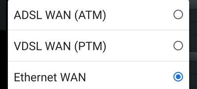

As per below it is actually Ethernet WAN already. The basic screen is confusing showing only ADSL or VDSL but once I go to advanced options I have below.

Did you try VDSL?
What other options are there for WAN connection type in that screen?

Just below three but I believe I need to use Ethernet WAN anyway as router doesn't have a proper WAN port, so I am using LAN port 1 as WAN

In the screenshot you posted WAN connection type is set to static IP, what other options are available?
