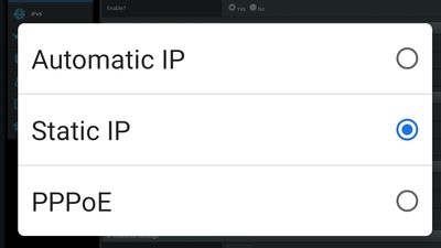

You could try automatic and get a DHCP address from the hub.
It seems weird that one screen seems to be expecting a PPPoE connection via DSL and requires a username and password whereas another screen seems to show an Ethernet connected WAN

Yeah I am about give up too. Not sure what's going wrong here.
I tried Automatic IP and making sure DHCP from the hub but still not working.
